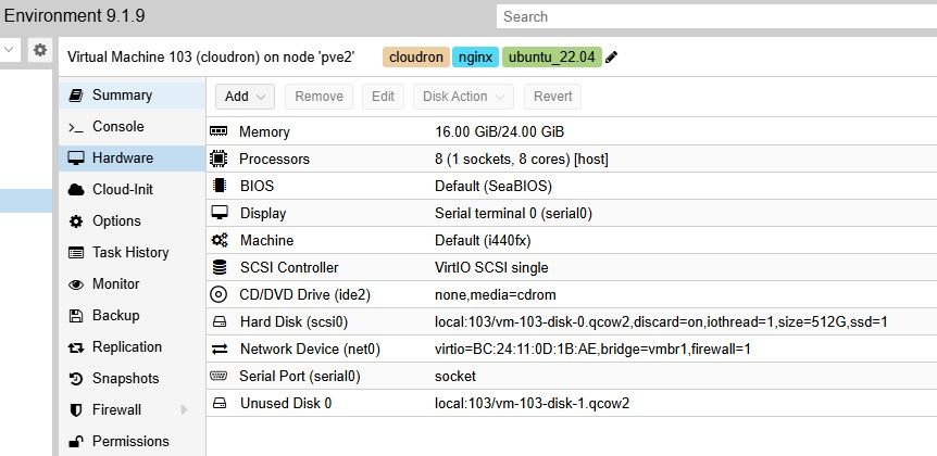

                    I run Cloudron on a dedicated VM, not as an LXC. It has been running flawlessly for about six months, with regular updates as and when they come out (to both Cloudron and PVE). The upgrade to 9.1.7 and today's PVE kernel update reboot are the only times this issue has occurred.

                      L Offline
                      L Offline
                      leighmhart
                      @necrevistonnezr said:
                      Also:
                      [FAIL] Could not load dashboard domain.
                      Hairpin NAT is not working. Please check if your router supports it
                      https://docs.cloudron.io/installation/home-server#nat-loopback
                      My PVE physical host is in a datacenter and all access to the apps are either public or private over VPN from my home site. I use split DNS where it matters which is preferable to NAT reflection in my use cases.
                      Cheers
                      Leigh
