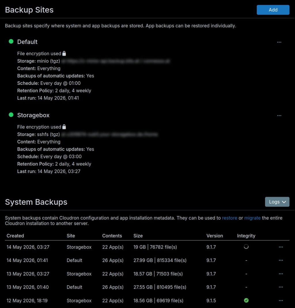

    I have a Cloudron (9.1.7) with two backup destinations, one MinIO and a Hetzner Storagebox. Both are set up to backup the same things every day, 2 hours apart.
    1. For whatever reason the MinIO backup (which was the default and only backup for years) lists also stopped apps even though they're not included in the backup, both in size and # of apps.
    Screenshot:
    1. When trying to do an integrity check on the MinIO backup, it says it crashed due to oom (ran out of memory or terminated). The server has plenty of RAM and the Storagebox integrity check works without problems.

    Could be that those 2 issues are related.
      For 1) the stopped apps don't create new backups anymore but the last created backup of those is still being referenced with the platform. This is to allow full Cloudron restore while not losing the stopped apps.
      For 2) the integrity check is actually run with a memory limit of 400MB, which is the taskrunner default as the intergrity check does not pass any options at: https://git.cloudron.io/platform/box/-/blob/master/src/backups.js?ref_type=heads#L223
      We have to see if it makes sense to introduce a setting for this or if we should just tie it to the memory limit set of the backupSite.
      • M
        msbt
        1. That I know, but how would I get the second backup site to include those? Eventually I'll switch to the second backup as primary and lose the secondary one when they're in sync.
        2. Right, but why does it work with the Storagebox and not MinIO, does that require more resources?
          If the second contains the System backups it would include those of stopped apps, where a backup was made there (since otherwise the backup data simply wouldn't be there). But I agree this is not great to migrate. I guess for now you would have to start the app, make a full system backup on the scondary backup site and then stop the app again.
