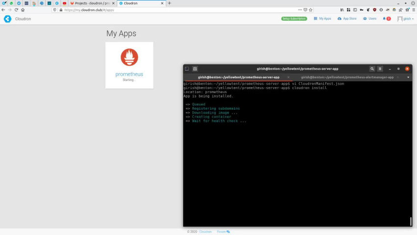

    I took a screen cap
      I was berated by @nebulon for not using our peertube instance 🙂 So, here you go:
      https://videos.cloudron.io/videos/watch/7774aa02-2256-4f76-b626-9ed78d96f535

        @girish do I get it right, that this is basically done without any modification of the app itself? Just turn on the add on and it will be used automatically?
        • fbartelsF fbartels
          @fbartels Correct. Just the one line added proxyAuth added to the addons in the manifest (~0:07 in the video). https://git.cloudron.io/cloudron/box/-/blob/master/src/proxyauth.js and there is the nginx config https://git.cloudron.io/cloudron/box/-/blob/master/src/nginxconfig.ejs#L238

                                I have put in this "proxy auth" feature in Cloudron 6. Just have to add it to addons in the manifest like:
                                "addons": {
                                    "proxyAuth": {}
                                Just like the ldap addon, user can then select which users/groups can authenticate. If the manifest also has optionalSso, then user can choose to let the app have no auth wall altogether.
                                When using this feature, two routes are "reserved" - /login and /logout. Some benefits of having this on the platform side (as opposed in the app are):
                                • 2FA login
                                • Session management in the user's profile page. i.e can logout from apps etc
                                • Easier for us to maintain this feature. Currently, this feature has already been re-implemented in the apps using 3 different stacks - nginx/apache/node...
                                I took a lot of inspiration from https://github.com/andygock/auth-server and @mehdi's transmission code. So, big thanks to them!
