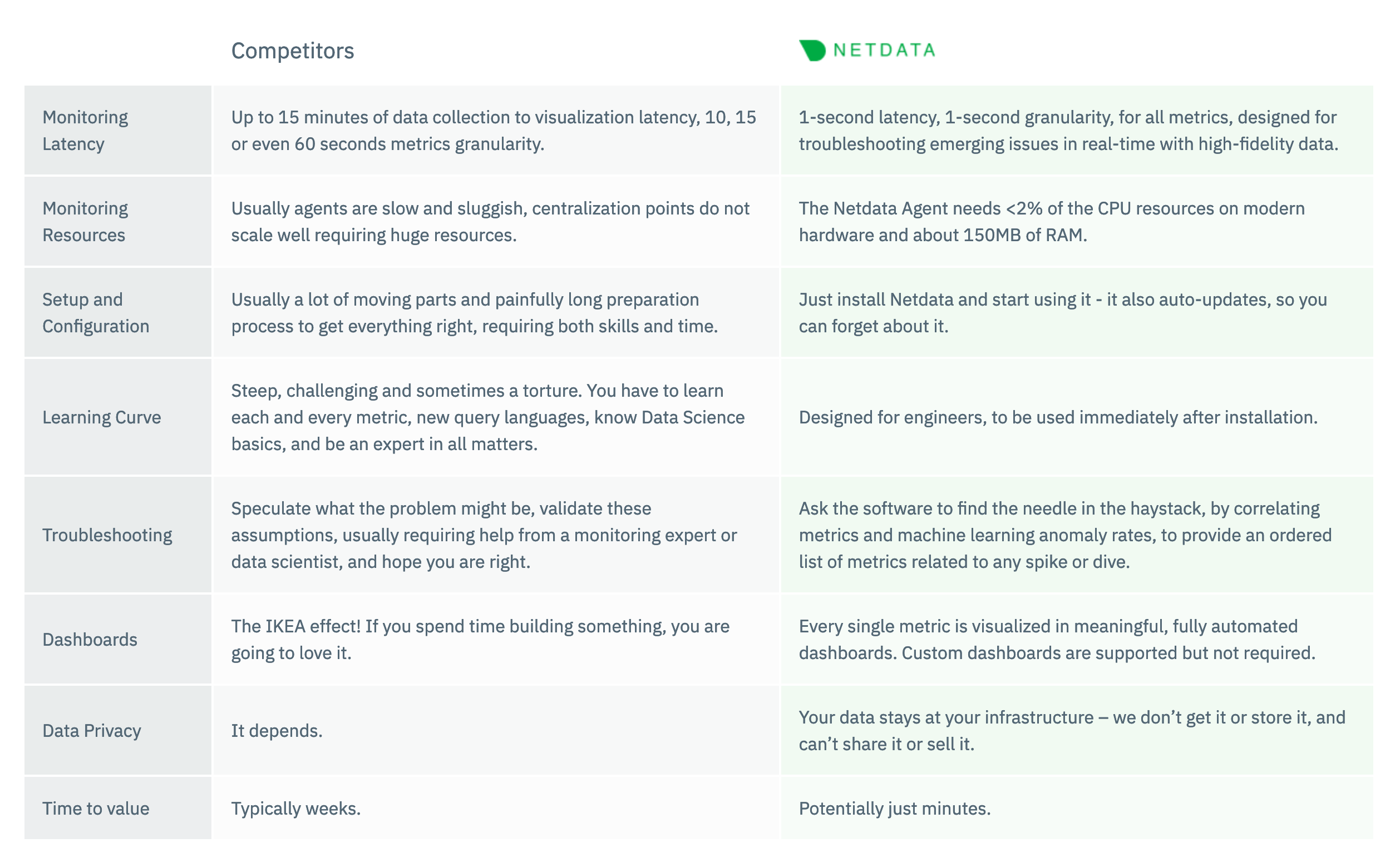

    • https://www.netdata.cloud/

                Yesterday I migrated my Cloudron to a new NetCup RS but before that I installed Netdata on the RS and then Cloudron. After installing both and migrating the data everything works fine!
                About Netdata:
                Before I used Zabbix for years but its much too hard to install, configure, update/upgrade and maintain. Netdata is install and use within seconds!
                I use the app.netdata.cloud dashboard and the Netdata agent on the Netcup RS is "streaming" data (have a look at netdata.cloud for all the details).
                The agent is streaming 494 (!!) different data sources and it is perfectly shown in summary dashboards, detailed graphs etc. right out of the box!
                They implemented AI (buzz) that is looking for correlations in captured data and with default triggers it sends you emails with warnings in different levels.
                Some first useful and surprising findings:
                • I got a warning that my mounted (!) Hetzner Storagebox for backups was 97.03% full (that is handy to know and act on!)
                • I got a warning that in the nginx logs in a certain time the ratio successful HTTP request was low. That was during my attempts to repair a stuck app!
                • All the Cloudron apps (docker containers) are monitored (alas with the not so nice cryptic names 😕 )
                • I got a warning that app.swap was almost fully used. Why?? The machine has 32GB RAM only 1 third used so I switched the slow app.swap off and deleted it (again a useful insight!).
                All together: it is very simple and useful!
