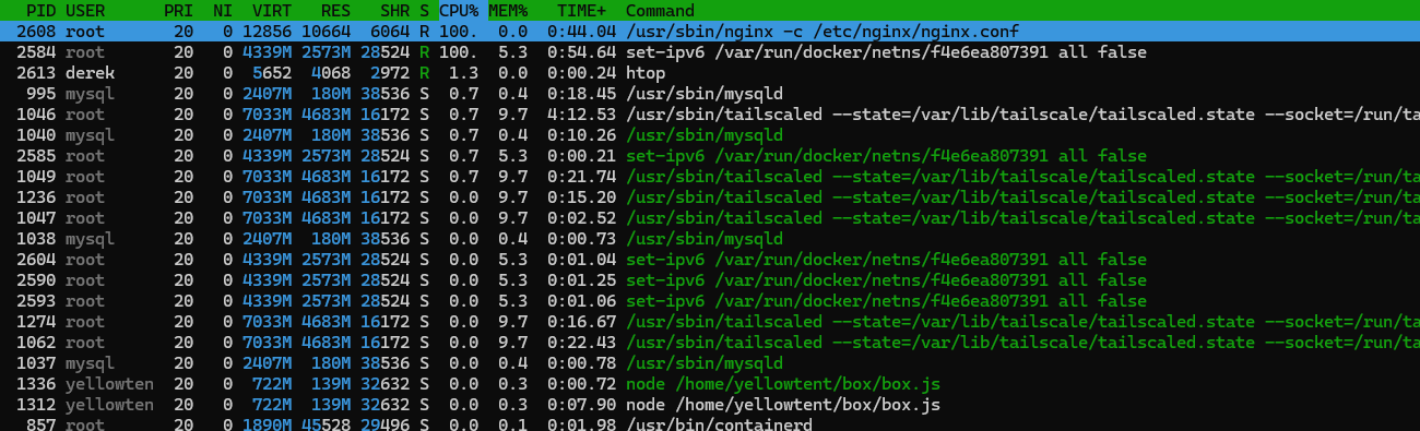

      htop gives a slightly better visual:
      Something about set-ipv6 maybe? (Not using IPv6 on this CR I don't think)
