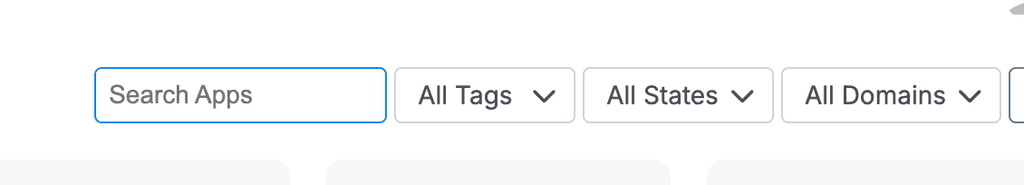

                When using the search, it should also return domains. Also, the domain filter doesn't search for redirects. And maybe the tags and domain filters should be searchable for people with lots of domains and tags?
                • andreasduerenA
                  andreasduerenA
                  andreasdueren
                  #75
                  Another thing I don't really understand is the current default sorting mechanism. it doesn't seem to srt by domain name or App name
                    #76
                    Right turns out the sorting in the grid view is actually by app id, which is just a uuid. That is indeed not great nor predictable.
                    I pushed a change to sort alphabetically by displayed label for a start now.
