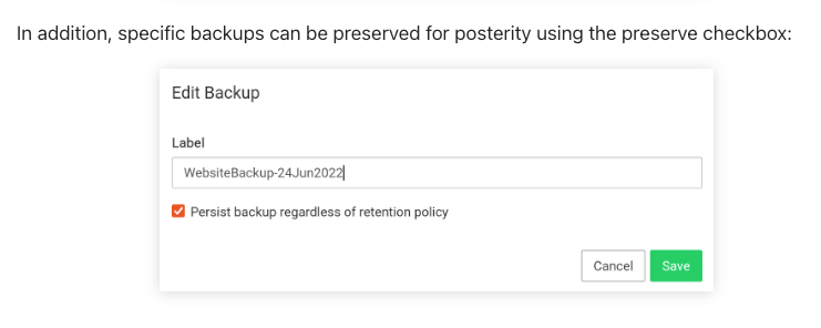

                      @scooke I can understand the logic, and I think I can fix this by making a manual backup persistent, but the documentation says here:
                      For installed apps and box backups, the latest backup is always retained regardless of the policy. This ensures that even if all the backups are outside of the retention policy, there is still at least one backup preserved. This change also ensure that the latest backup of stopped apps is preserved when not referenced by any box backup.
                      So either this is not working as intended, or the documentation needs to be updated, I think.

                        @daixiwen Even better, they HAVE already allowed for specific backup persistence:
                        I'm going to go try that out.
                        The wording definitely makes it sound like at least one backup, "the latest backup", should be available, but my point still stands. As perfect as Cloudron is, I've bumped into hiccups with backups myself, too. And so I pay close attention to them. In the situation you mentioned, you can either let your stopped app backups keep disappearing while you wait for a solution, or you can realize it needs a bit of your help. EDIT: I see you wrote " I'll now try having at least one manual backup set up as persistent and see in two says if it's still there, but ideally this should occur automatically." so good on you for taking it into your own hands. Let us know what happens!
