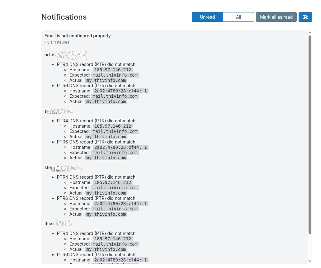

                    Moreover the Cloudron Trouble shoot command is asking me something different from the Cloudron mail settings....
                    Mail settings
                    How can I have a PTR on my.thivinfo.com asked by the troubleshot command and to mail.thivinfo.com ?
                    Mail.* is my mailserver location on the settings due to long time setup before I migrated to Cloudron)
                      Hello @sebastienserre
                      The PTR record is set up from your hosting provider.
                      For Example Linode for my.cloudron.dev where the mail subdomain is also my.cloudron.dev:
                      I just took your domain my.thivinfo.com and get the IPv4 and IPv6:
                      dig A my.thivinfo.com +short
                      185.97.146.212
                      dig AAAA my.thivinfo.com +short
                      2a02:4780:28:cf44::1
                      Also checking the MX record:
                      dig mx thivinfo.com +short
                      10 mail.thivinfo.com.
                      So the PTR/rDNS should resolve from the IPv4/IPv6 to mail.thivinfo.com:
                      dig -x 185.97.146.212 +short
                      my.thivinfo.com.
                      dig -x 2a02:4780:28:cf44::1 +short
                      my.thivinfo.com.
                      Both resolve to my.thivinfo.com which is incorrect, and thus mail server are blocking your mails.
                      Go into your hosting provider interface not Bunny DNS and configure the rDNS/PTR record to be mail.thivinfo.com.
