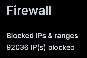

            @girish indeed I noticed git.cloudron.io gave a 403.
            As you might remember I created my own "security monitor" for centrally monitoring and managing 3 Cloudron servers, it's growing with hundreds a day, the list below are lines, the unique IP's are 641.451.742 separate IPv4-adressess:
            • imc67I imc67

                haha (sorry) now you experience the same as I do, every hour the newly to be blocked IP's are pushed via API and it takes 4-6 minutes to be processed. That's why I suggested previously in a post to maken it "insert/update/delete" per IP or CIDR.
                Good luck!
