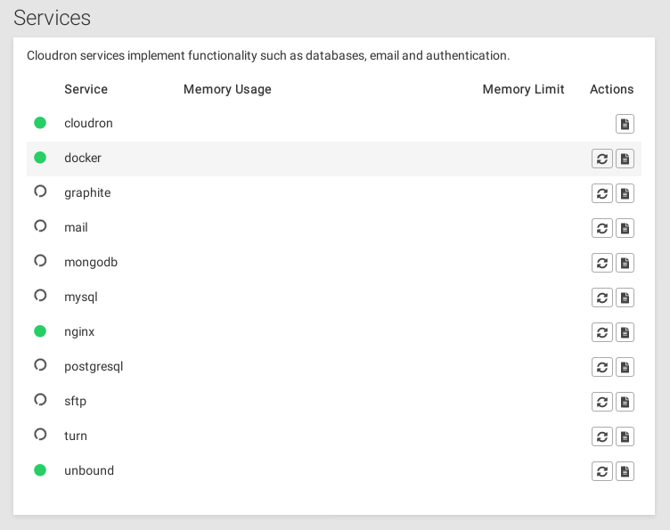

                  • ruihildtR Offline
                    ruihildtR Offline
                    ruihildt
                    FYI, I have the same errors:
                    I clicked on an error box,there wasn't any error in the server log.
                    And in the console:
                    https://paste.cloudron.io/utococaruh.rb
                    On the same page, Services part was also wrong: the following services never stop from loading and don't show their status:
                    These issues stayed across several cloudron updates and a reboot.
                    What can I do to help you debug this?

                      d19dotcaD Offline
                      d19dotcaD Offline
                      d19dotca
                      @ruihildt It might be worth creating your own post to troubleshoot that, because while you say it's the "same errors", it actually looks quite a bit different from what I reported. For example, I never once had any "Cloudron Error" message nor a message that stated "Error loading disk : Empty message or object". Your issue seems quite a bit different other than affecting the same page in the admin UI.

                        @ruihildt The issue in your case was different. There were so many apps that the query parameter limit was getting exceeded. This is fixed in next release. @necrevistonnezr this is most likely your issue as well!
