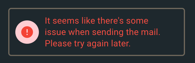

      @marcusquinn Good catch. Fixed. If you open up /app/data/config/project.php, change the email section to be like this (the 'from' and 'host' were set incorrectly):
              'default' => [
                  'transport' => 'smtp',             // How to send emails. Supports `smtp` and `sendmail`
                  'from' => getenv('CLOUDRON_MAIL_FROM'),  // The sender of the email
                  'host' => getenv('CLOUDRON_MAIL_SMTP_SERVER'),
                  'port' => getenv('CLOUDRON_MAIL_SMTP_PORT'),
                  'username' => getenv('CLOUDRON_MAIL_SMTP_USERNAME'),
                  'password' => getenv('CLOUDRON_MAIL_SMTP_PASSWORD'),
                  'encryption' => null

          marcusquinnM Offline
          @girish Thanks. Confirmed Solved.
