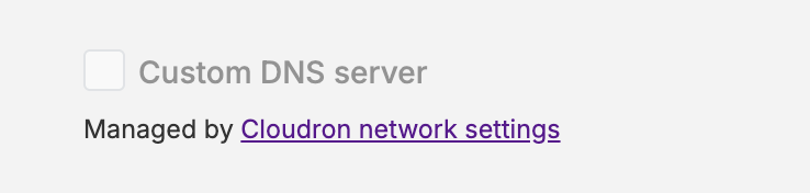

    Hi,
    Today I installed the VPN app on another server. Everything looked ready, but I couldn't connect.
    I found the cause: none of the profiles have a DNS address assigned. There is no way to set it
    manually in the VPN settings – it redirects me to the Cloudron dashboard, where there is no such option.
    Is this a bug, or where can I set the DNS for the VPN profiles?
    Thanks!!
