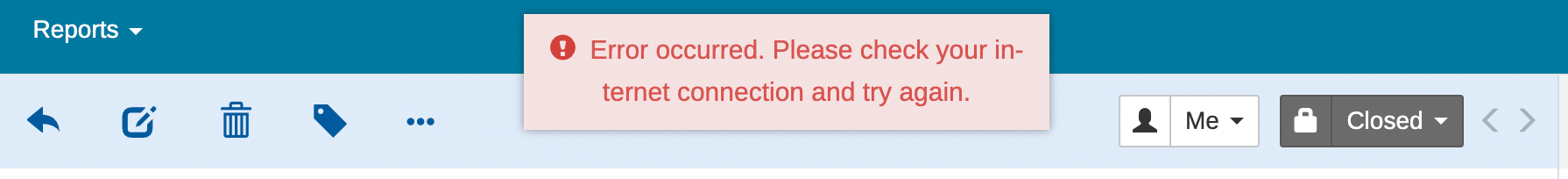

    After upgrading to the latest version FreeScout 1.8.178, I started encountering a persistent issue. Whenever I perform any action on a ticket (changing status, adding a note, replying, etc.), I get the following error message:
    ❗ Error occurred. Please check your internet connection and try again.
    Screenshot:
    This issue only started after updating to version 1.8.178. When I rollback to the previous version, everything works perfectly.
    Thanks in advance!

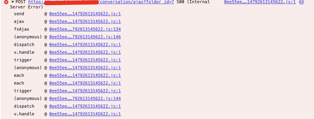

            Our support/FreeScout instance works fine. Are there any errors in browser console?
            vadimV 1 Reply Last reply
              vadimV Offline
              vadimV Offline
              vadim

                  Found the issue: after updating to 1.8.178, the Faster Search module causes a fatal error in line 731 of its provider. It's passing a string to count(), which expects array|Countable. Disabling the module resolves the error.
                    The 500 status code from your screenshot also hints at a server side exception or crash, maybe worth looking into the app server side logs while that happens. Maybe the crash can then be reported upstream for that faster search module
