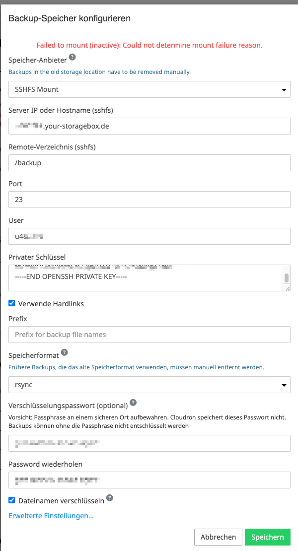

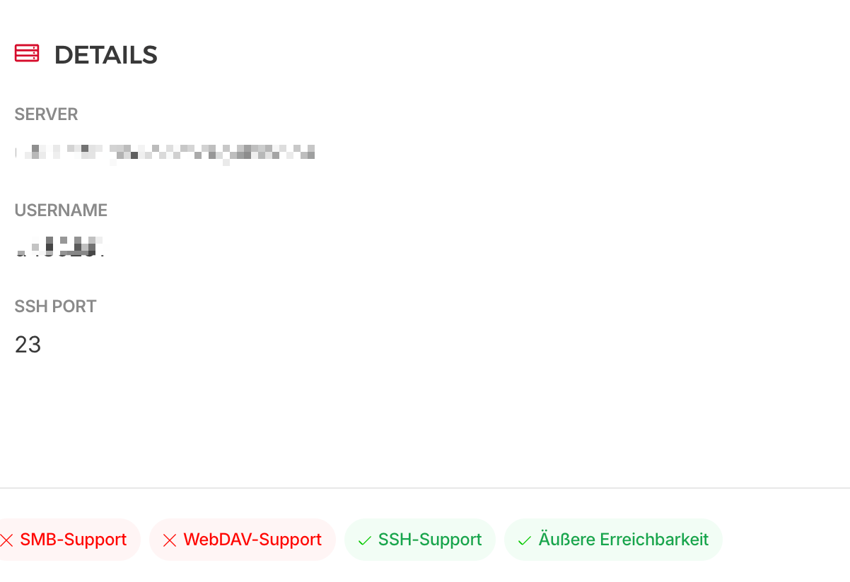

    In the screenshot are my current settings. tried a lot but everything i get:
    Failed to mound (inactive): Could not determine mount failure reason.
    🙄 no idea what that means.
    Tried subaccounts, different folders …
    Thanks for Help.

      Hello @JueBam
      From my experience and the offical doc https://docs.hetzner.com/storage/storage-box/access/access-ssh-rsync-borg
      When using sshfs with Hetzner Storage Boxes you have to use /home not /backup.
      Also, this is not documented anywhere, but Hetzner Storage Boxes with ssh access use fail2ban.
      Meaning, now that you have failed multiple attempts of authentication your instance is blocked for approximately 15 Minutes.
      This block can be resolved faster by contacting the Hetzner Support.

        Yes, /home is the correct path. FYI, encrypting file names will most likely create issues and not work. I also have hard links disabled because I think that had issues too.

                Hello @JueBam
                Did you put your ssh public key into the storage-box?
                Maybe you can give us some more details so we can figure out this issue together.

                  I had a similar issue as you face now @JueBam , you might want to whitelist some ports on Hetzner side as by default Hetzner blocks traffic on ports 22 and 23 - see
                  https://forum.cloudron.io/post/105514 and https://forum.cloudron.io/topic/12692/backup-failed-backup-endpoint-is-not-active-could-not-determine-mount-failure-reason-failed-to-mount-inactive-could-not-determine-mount-failure-reason/2
                  And unfortunately Cloudron does not disclose the error details when you face this kind of troubling situation. This was already expressed in the first topic I refer to and should ideally be part of future Cloudron UX improvements.

                    @james Currently, I'm already failing at logging in ;/ Waiting for hetzner-response.
