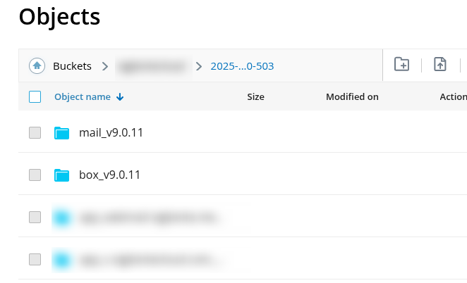

                    I have the same problem. Previous import backups worked, previous to 9x. I'm also using the same exact backup paths.

                        @mdc773 no, 9.0.11 does not work, and I doubt any 9x does. I know 8x works. 9x has too many bugs

                              @mdc773 you marked this as solved? i still have the same problem. 1ba0f4f4-1d9c-4c91-bcee-420c802f9283-image.png 4

                                    @ghosted @mdc773 sorry for the inconvenience, a fix is coming, most likely later today. In the meantime, if it's urgent, you can write to support@cloudron.io and we can patch your server individually for this bug.
                                    The issue happens when the import/restore form is filled up manually. If you use a backup config file, it works.
                                    To workaround:
                                    • Download the backup config of any current app. App -> Backups -> Select backup -> ... -> Download Config to your desktop.
                                    • Edit that config json file on your desktop and change the remotePath field.
                                    • App -> Backups -> Import -> Upload a backup config .
                                    This works because the config file sets prefix to "" internally.
                                    • girishG
                                      @ghosted @mdc773 9.0.13 has the fix .
