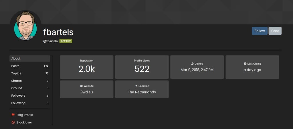

      @fbartels I think the more that can be done to help users do a bit of due diligence on community apps the better, hence why I'd at least like links to the packagers profile on here, see https://forum.cloudron.io/post/126905
      I like your suggestions, and really I'd like all/most of the stats shown on profile pages on here to be pulled through to the community app store
      From that I can see you've been using Cloudron for years, have packaged official Cloudron apps etc. Such things would make me much more likely to trust community app packaged by you 🙂
