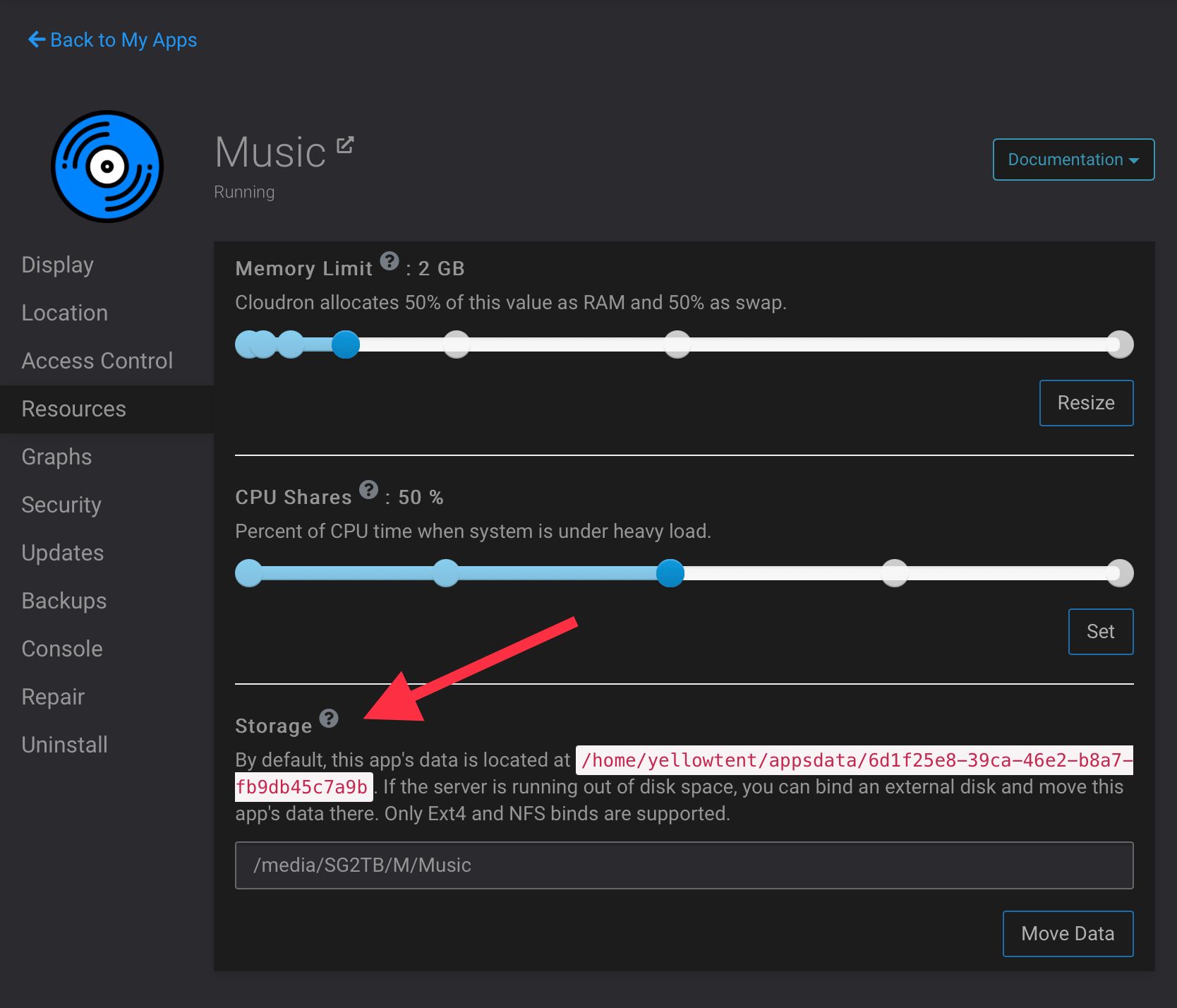

                      necrevistonnezrN Offline
                      #44
                      @nebulon said in What's coming in 6.0 (take 2):
                      The volumes are setup outside of the apps first and are essentially independent. Once you've created a volume you can then mount that into an app via the Storage section in the app configuration. Even if mounted though, it will not be part of the app backup, since the main reason for volumes is to be mounted into multiple apps. For that we have to first figure out how to manage those with regards to backups.
                      No, I mean external volumes that you can currently already move the data dir to under „Resources“ in the app settings - this gets backed up, correct?
                        #45
                        We haven't decided on the naming yet, but maybe Volumes can be instead renamed to External Media or something, if it clarifies things. Open to other suggestions as well.
