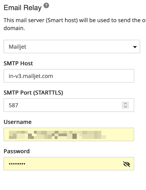

    Hello!
    I try to set up my mailjet account as smtp server.
    I get the following error: getaddrinfo ENOTFOUND in-v3-mailjet.com
    Username and API Key is correct (I use this in another app, too)
    SPF setup is correct, as I can see in the mailjet console.
    Any ideas?
    Thank you!

      msbt
      @Fabix not sure about the missing username, but your SMTP host has a - instead of a . (should be in-v3.mailjet.com)

        Fabix
        @msbt
        oh man so sorry..
        yes it was the wrong smtp host...
        In mailjet it was not possible to copy the host.
