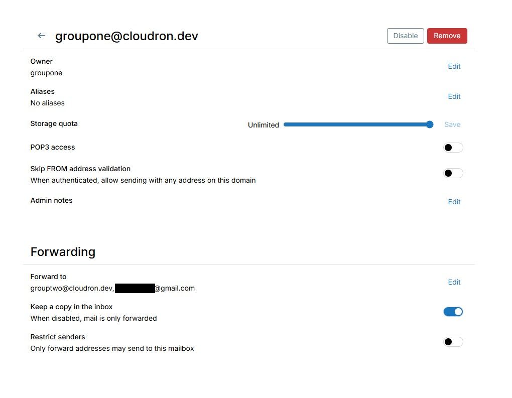

                @james thanks for testing! In my setup the groupone@ is a regular user with 40 forwarding addresses and grouptwo@ is a shared mailbox without any forwards, but other than that you're right.
                So the only difference is that groupone is owned by a single user, not a group and grouptwo is a shared mailbox with no forwards.
                I can't imagine how single user vs group owners would make a difference. Did you chance anything else, like FROM address validation? Keep a copy in the inbox? Restrict senders?

                    @james can you try again without the "Keep a copy in the inbox", that's the only difference I'm seeing
                    edit: and maybe remove grouptwo from forwarding as well, but again, no idea how that could make a difference 😆
                      #28
                      Hello @msbt
                      No difference. Still working just fine.

                        This stood out. There is a cap of 64 forwards in the code. Could you be hitting this limit? Specifically sieve_max_redirects is 64 . I thought this was a very high number, may be not?
