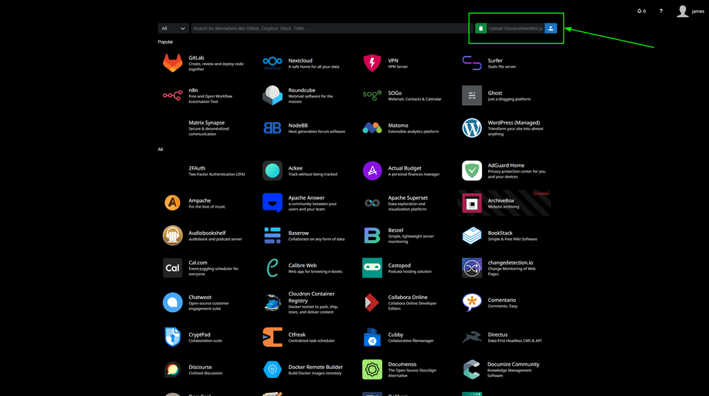

        What do you people think of the following?
        Adding an input field in the app-store view to directly upload a CloudronManifest.json.
        Mockup:
        To make this work, a new optional 'key': 'value' in the CloudronManifest.json would be needed to add the Docker Image information so Cloudron knows where to pull the image from for this custom app.
        Example from @BrutalBirdie custom FounderyVTT app => https://forum.cloudron.io/topic/8296/foundry-virtual-tabletop // https://github.com/BrutalBirdie/cloudron-foundryvtt

        This would make the barrier relatively small in my opinion.
        Looking forward to reading your opinions.

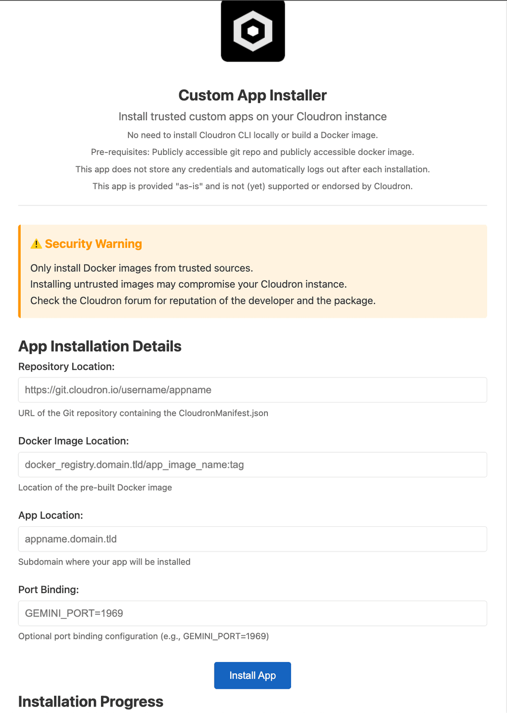

            OK, so <nervously> how about this ?
            Not sure if it gets me banned πŸ˜† for side-stepping Cloudron process.
            But all I am doing is presenting the Cloudron manual process for custom app install in a GUI with backend execution.

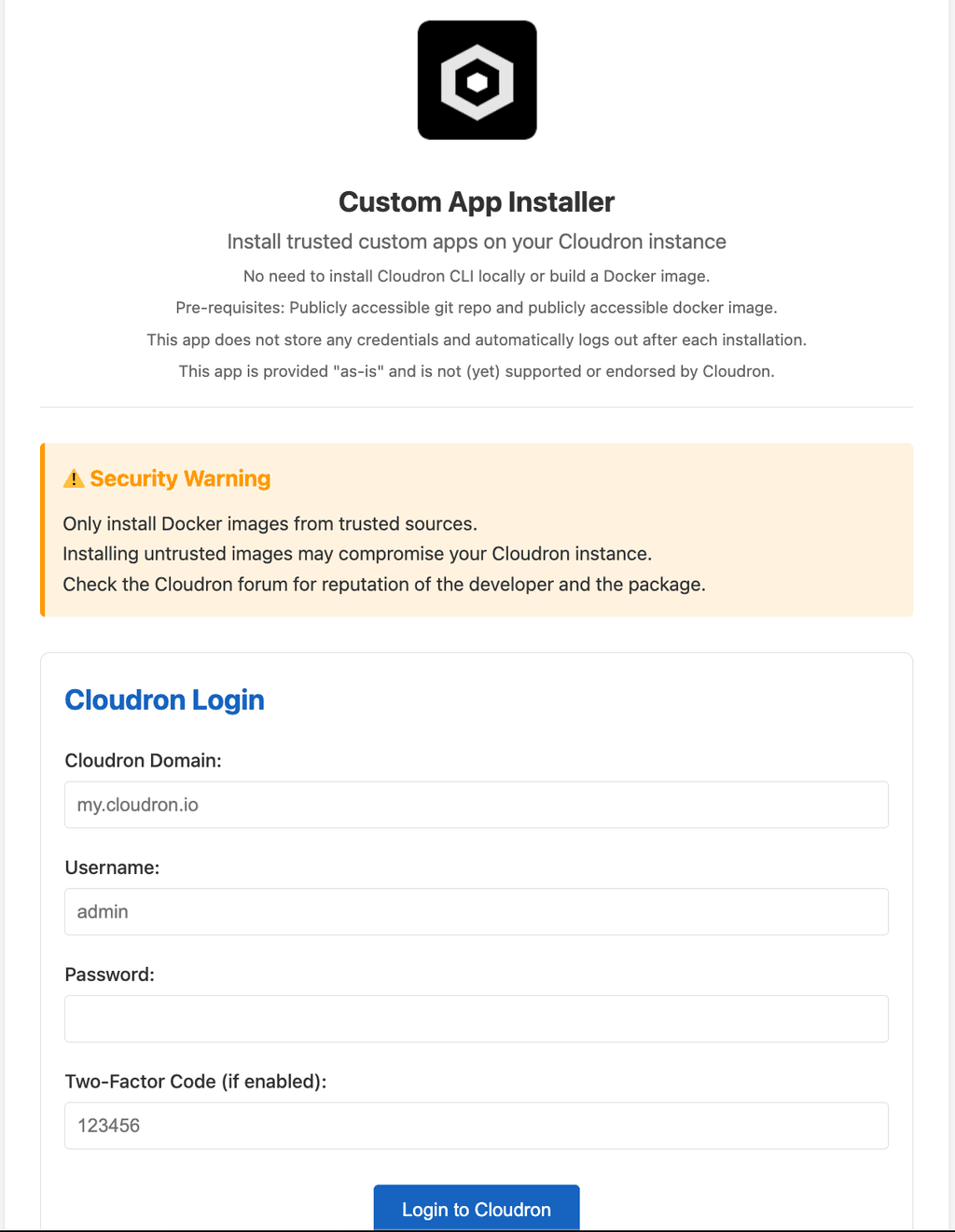

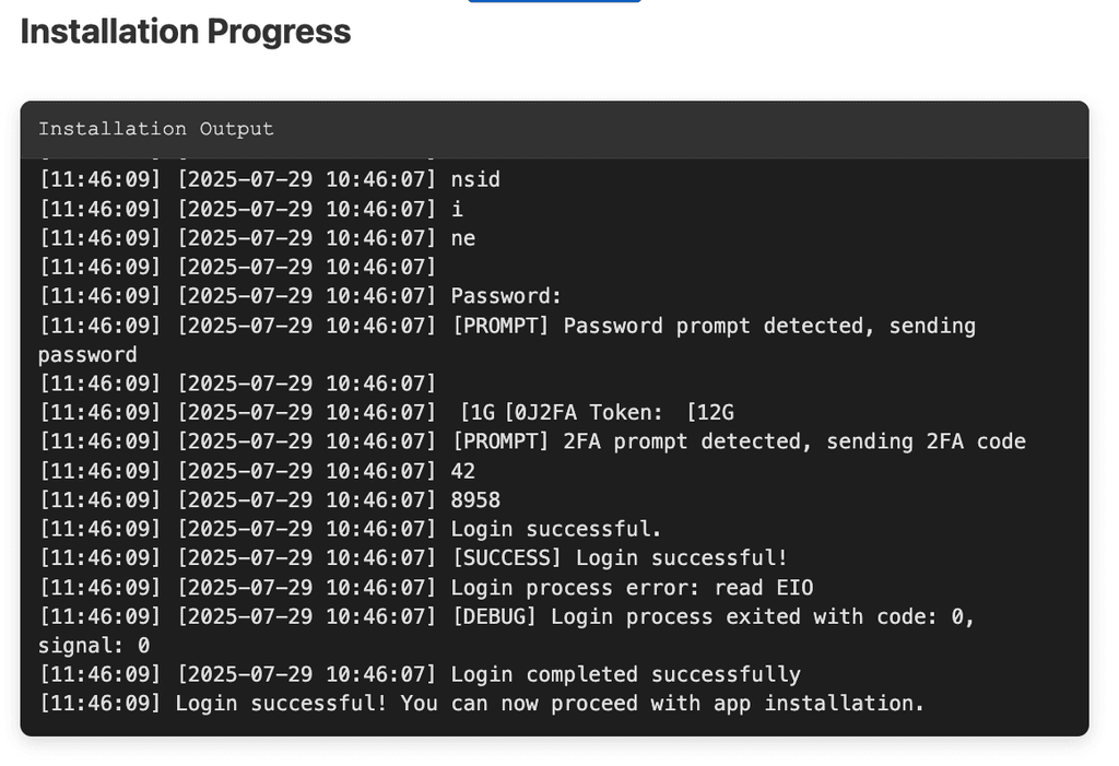

            I present <drum roll> for your review and comments :
            "CCAI" a Cloudron Custom App Installer.
            A GUI which :
            • logs the user in to their cloudron,
            • gets details from the user of the target custom app to be installed,
            • performs the custom install, and
            • logs out on completion (and on error).
            Features :
            • security sensitive : no login details saved
            • user does not need to install CLI on their local device
            • user does not need to use the scary terminal on their device
            • user does not need to download or clone any custom app repo
            • user does not need Docker installed, and does not need to build a Docker image
            Pre-requisites :
            • the target custom app's publicly available git repo containing CloudronManifest.json and an icon file, e.g. logo.png but whatever, and a POSTNSTALL.md
            • the target custom app's publicly available hosted pre-built docker image
            Demo Site : https://ccai.appx.uk
            (may go up and down as further tweaks are made, available for your review and live usage)
            Source code available at https://git.cloudron.io/timconsidine/cloudron-customapp-installer
            1. EITHER :
            • install CCAI (ah, maybe a gotcha, you have to do it manually for now, but I'm hoping Cloudron will approve this as an app),
              OR
            • use a kind developer's "hosted-as-a-service" CCAI (see BONUS below)
            1. visit e.g. ccai.domain.tld (or try https://ccai.appx.uk)
            2. enter data
            3. enjoy the new custom app installed on your cloudron.
            NOTE : developers who want to share their custom app should make a pre-built image and host it at a publicly accessible docker registry. But hey, if you can make a custom app, you can build and host a docker image.
            BONUS :
            Although not designed deliberately, as an unintended bonus, once CCAI has been deployed, it should be able to install a custom app on any Cloudron (provided access is granted).
            So actually user does not need to install their own CCAI, unless they want to for privacy. They can just use another deployed instance, e.g. from a custom app dev, or even from Cloudron itself.
            Feel free to anonymously use my deployment https://ccai.appx.uk to install custom apps to your own cloudron (no login or usage details saved).
            WARNING - this is an alpha release.
            I need to test with more custom apps (only done my own).
            Volunteer testers very welcome !
            So ... @staff would you be ok to make this an official App Store app ?
            Feel free to re-write it however you wish, you're the professionals, I'm just hacking about πŸ˜†

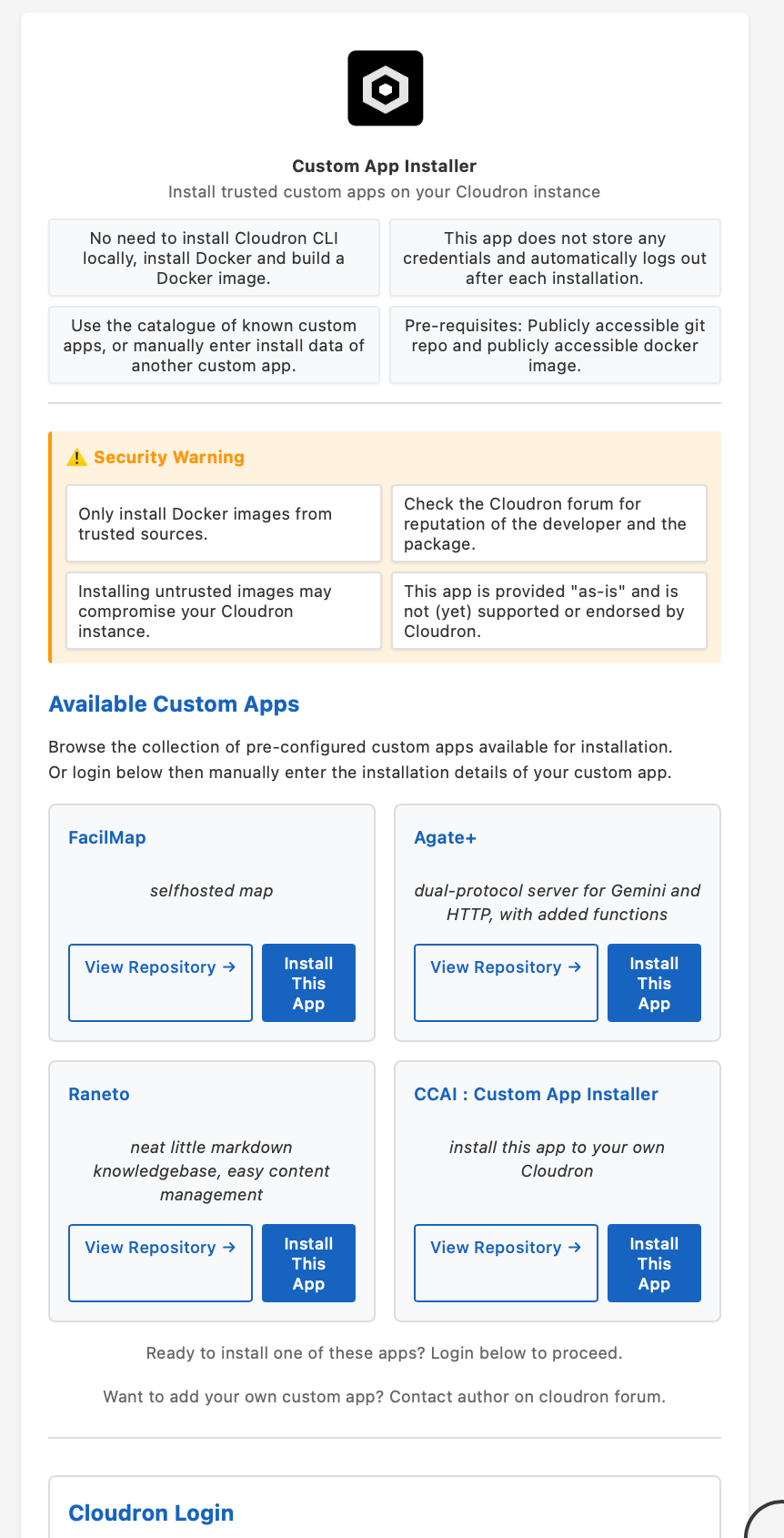

              Admittedly CCAI as above does nothing about "discovery" of custom apps.
              I favour low-tech approaches where possible.
              Why not just make a new forum category "CustomApps" ?
              One post for each custom app a dev wants to make available.
              Some 'house rule' that custom apps must be maintained by the original dev, and if that ceases, to update the post accordingly.

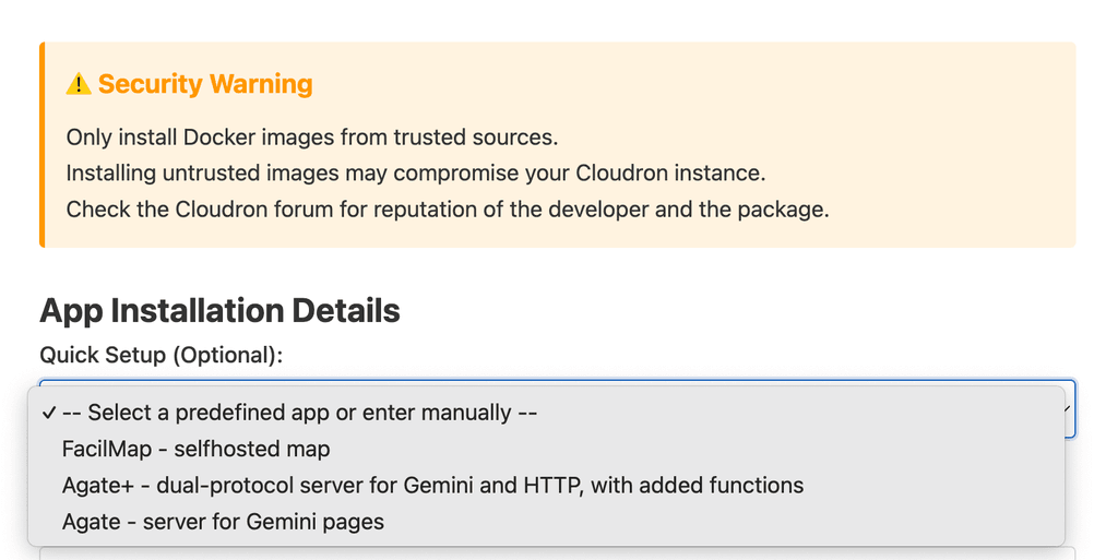

              EDIT : CCAI could be extended to load a custom app install data from a dropdown list of known apps, in addition to manual entry of a custom app's data.
              EDIT #2 : CCAI now has a dropdown to populate known custom app install data.
              Makes testing easier.
              Because finding a custom app with pre-built docker image to deploy is not easy.
              And it could be valuable functionality if the app is left running as a service.

                          For those not wanting to spend time on installing or using deployed instance, here's a 2min video showing the process.
                          https://ccai-demo.appx.uk

                              Now it also has a simple catalogue (not in video - I will update it).
                              Not quite 1-click install, but close.
                              So it could become an App Wishlist item.
                              You should even be able to use the hosted ccai.appx.uk to install CCAI on to another Cloudron for private deployments !
                              Yep, stay focussed on your release - much more important.
                              When you're ready, I think there is mileage in this approach, even if it is re-written from scratch on similar approach.

                                        There is also this topic Proposal: The CUR - Cloudron User Repository
                                        Mockup:
