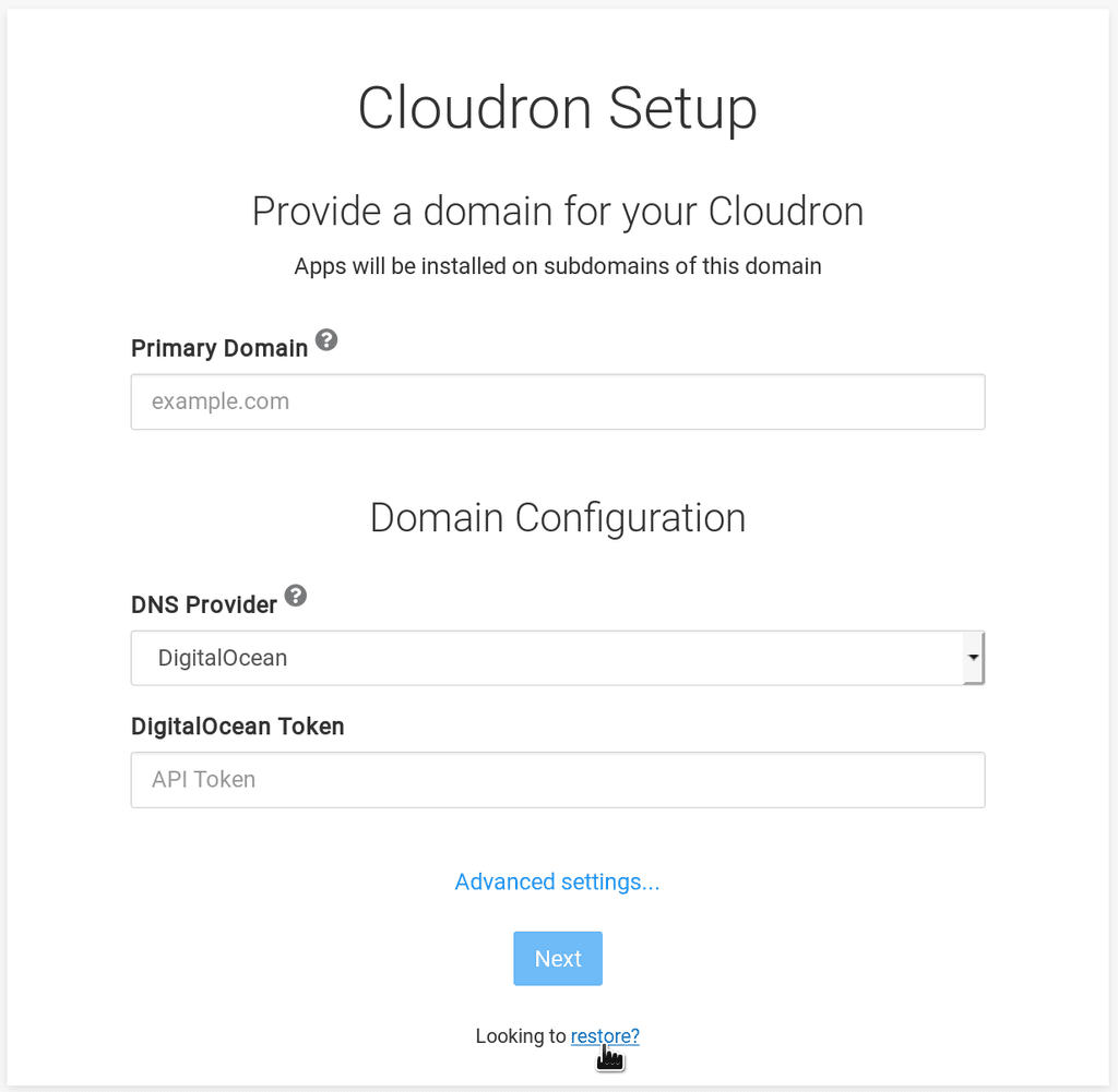

          @leemuljadi also, I'd recommend keeping your existing server intact and using the Dry Run feature and only update the DNS to point at the new server once you're happy everything is running smoothly on the new server.
          But yeah @crazybrad is correct: use the Cloudron backup. I've done it a few times now without any issues other than:
          1. forgetting to install the correct version of Cloudron as per @BrutalBirdie , or
          2. forgetting to click the tiny "Looking to restore" link at the beginning as shown here: b833b83b-c3c0-4aff-8051-f2a994dead45-image.png
