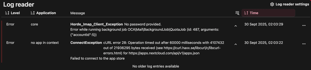

                                  Pretty new clean install, too.
                                  Logs:
