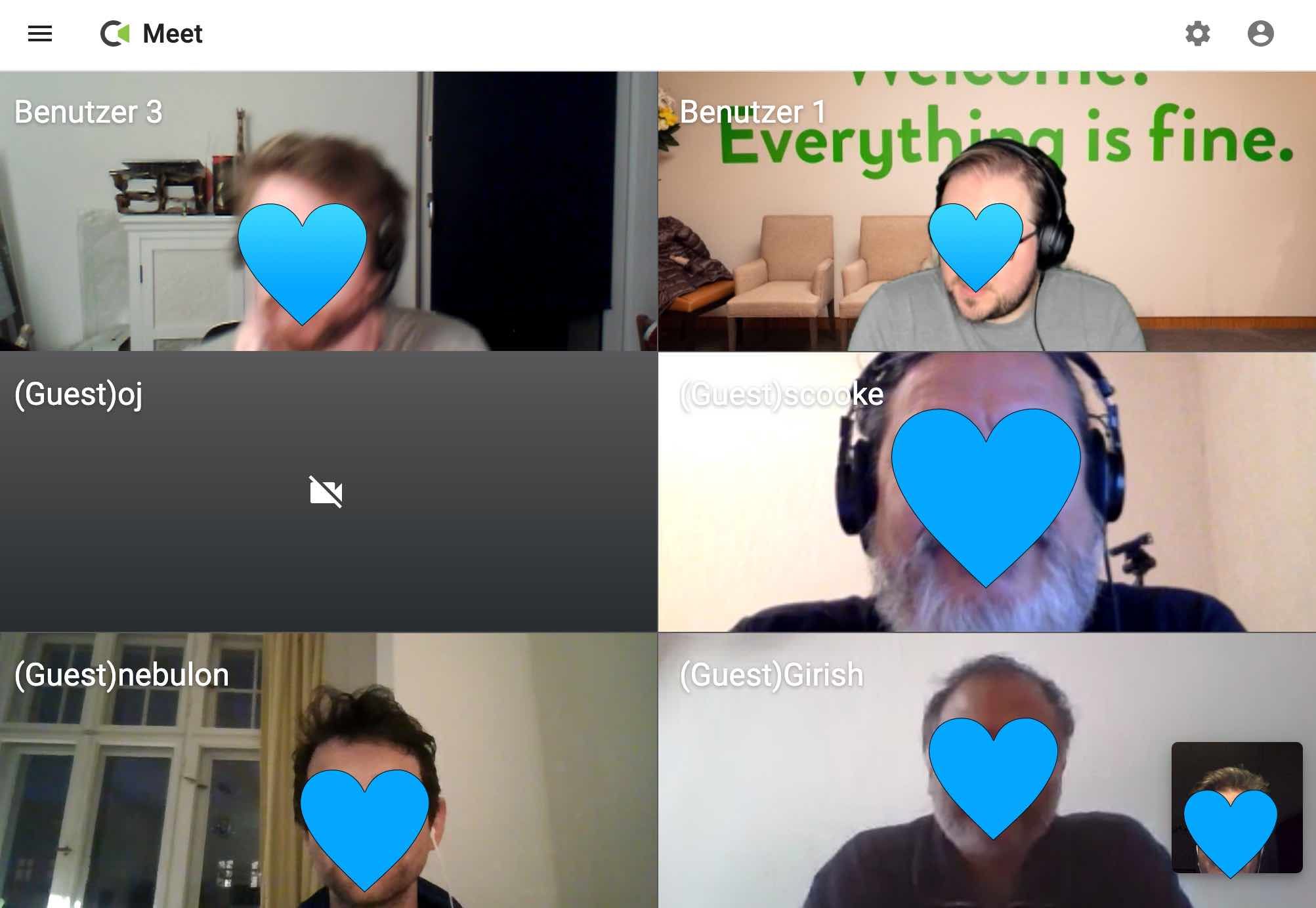

                                        #52
                                        Charming participants at the first (virtual) Cloudron meetup 🙂
                                        O 1 Reply Last reply
