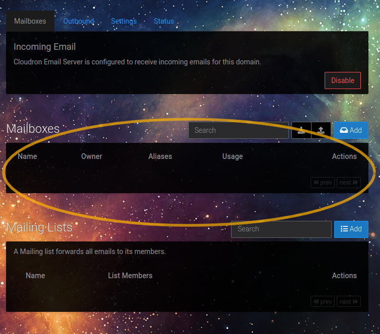

  • Can't manage existing email address since v7.3.4 update
    T TheNils
    Support mail

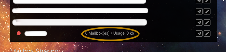

    Hi there
    i can't manage existing email since v7.3.4 update , the page at /#/email/domain.com/mailboxes show a empty list under "Mailboxes"
    empty email list
    cloudron-email
    as you can see on the second screenshot there are 6 mailboxes on this domain ( see the wrong "usage: 0Kb" and the red status dot should be green )
    T TheNils
    Support mail
    @girish waiting for five minutes worked and the email list got hydrated.
    I've just spotted that sometime the list appear for less than a second, just before reloading when i hit F5 or CTRL+R . seems like some async state reactivity issue.
    also if i wait on the emails resume page at /#/email i see the usage getting updated but the status dots stay red (except for the first seven domains which have a green status dot)
